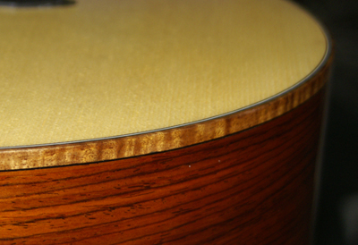

Here's a guitar I'm working on right now that has coco back/sides and a spruce top. I used bloodwood binding and curly maple purfling for the sides and back, and LMI's bwbw purfling for the top.
I like bloodwood for binding, especially with cocobolo.
The coco was from the Zootman, btw.

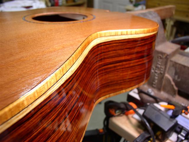

Here's a combination I have gotten a few compliments on...Curly eucalyptus (from the Zootman), b/w/b purfling on the top, black purfling on the sides:

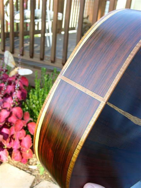

Depends on what your going after, Ebony is going to be a calming out line, that is great! Especially on highly figured woods. But if your going after flash, flamed maple or Koa or something of that nature looks great too!
On this guitar, we minimalized (<-- is that a word?) the top and side purfling and flashed up the bindings.
